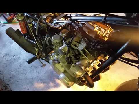

      And it sounds good. No smoke.... No oil pressure light either, but running a multi meter across the oil pressure switch confirmed no resistance with engine off (open circuit), and infinite resistance with the engine running.

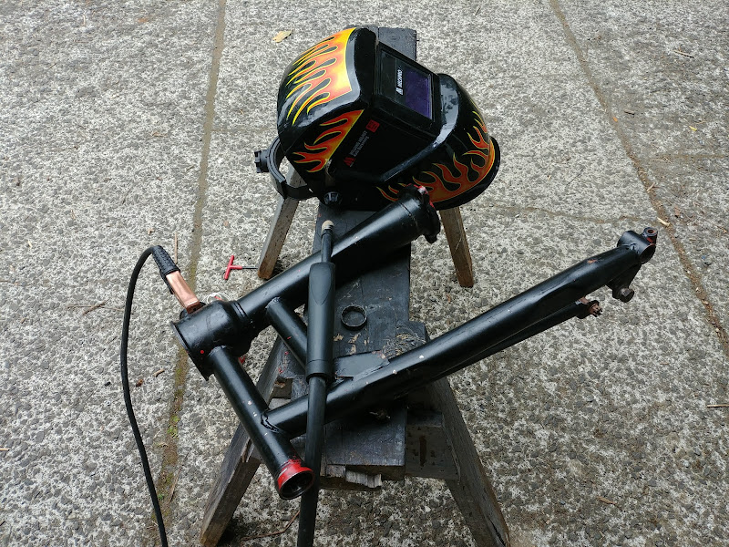

        About to shrink some bearing races
        Great success.

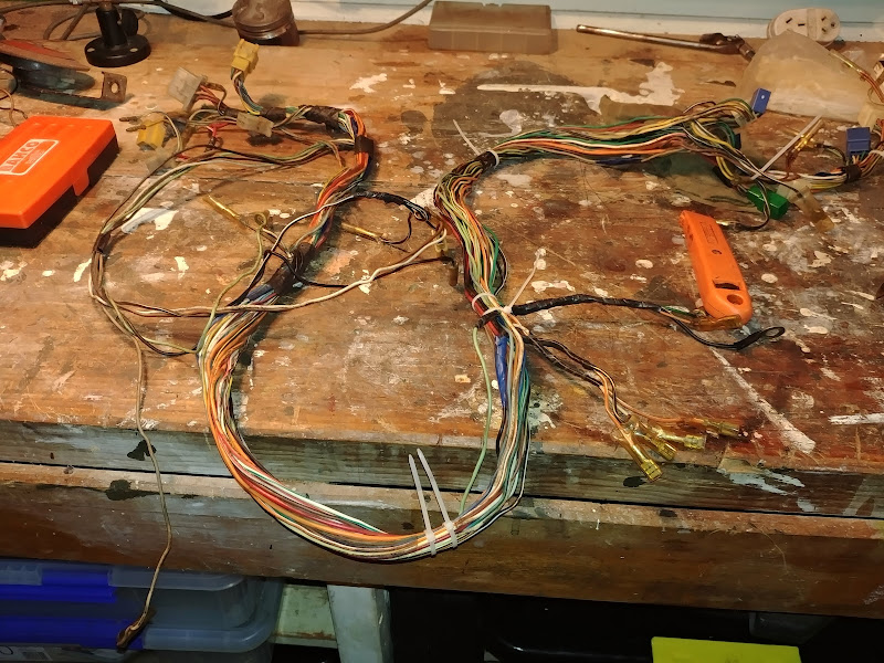

            This is pretty much how the loom came of the bike. Apart from about the coil leads north to the headlight, that was wrapped with duct tape from last century. Have already seen an earth wire that has lost a bit of insulation. Testing the wires terminal to terminal with the multi-meter for continuity and then will re-wrap properly, I do have some Nitto self -amalgamating tape and may use this, or get some loom cloth tape (may be a combination of both?). Have cleaned a couple of the connectors using a circuit board degreaser aerosol and the results were startling. After a few seconds and a little agitation, it dissolved corrosion and left bright brass behind with no damage to anything else.
            Once the main loom is done, I'll check all the switches, bulbs, etc.
            Seriously considering lifting the motor out of the frame..... one thing leads to another....

              Loom finished. Continuity tested. A section of earth wire replaced that had lost a fair bit of insulation.

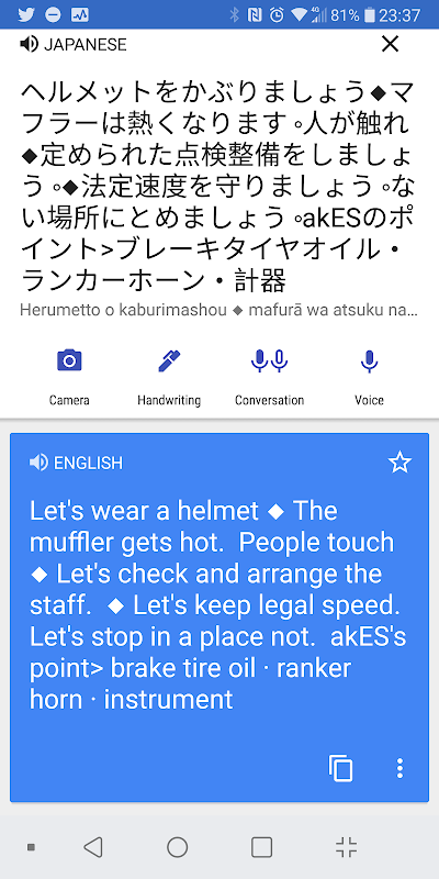

                And one thing leads to another. Disassembled, cleaned, tested and reassembled. Frame number identifies it as a Z model, and the tacho, speedo and the 'you naughty, naughty boy' 80 kph+ warning light also ID's it as a JDM. I have hazy recollections that a shipment of cheap JDM 650's being sold in NZ in 83' as they didn't shift in Japan as well as Suzuki had anticipated.
                Used Google translate for the sticker on the tacho.
                "People touch", they just do Pete. You've been warned!
                I quite like how the other warnings are in reality polite suggestions. "Let's wear a helmet", could easily be followed with '...and why don't we do lunch?'
