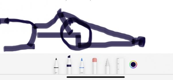

              @Darthjames21, any progress on getting the wheelie bars mounted? Photos will help.
              I assume your bike still is a twin-shocker. The top mounts probably may be a good place to install the upper arm of the wheelie bar.

                  I don’t know if this will help you or not what do you want to position the bar mounts something like this.
                  It’s a crude drawing but you can see the lower bar goes under the axle and the top mount goes above it

                    #39
                    thats the plan actually, i got a few mock up pics but of course i cant find my damn cable to connect my phone to my computer gunna have to finnish welding the wheelie bar at thr track thursday night when i get there. i desided to remake the whole thing as the 1 i bought was just a little too mush to redo it to make it fit, but i got almost everything, gotta hit menards tomorrow for a few more small pices.
