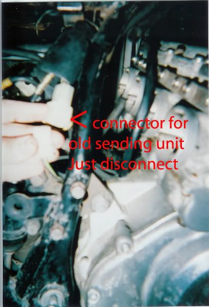

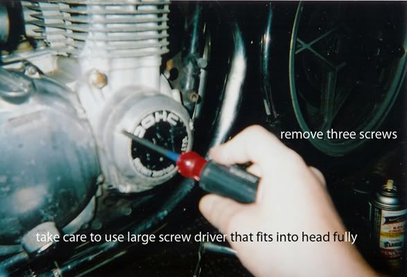

    Dyna S install on a 1980 GS550 E
    Step a. remove case guards
    Step 1. remove cover
    Step 2.
    Step 3.
    Step 4.
    Step 5.

      8.
      9.
      10. with the 1/4 showing, make sure to have magnet facing left
