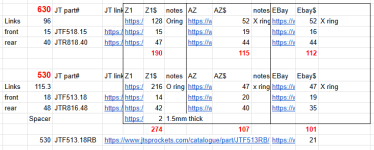

630 to 530 chain/sprockets on 1981 GS750L - Do it? Looks like the OEM teeth counts are 15 front 40 rear
It's time to replace my front sprocket (and the chain has lost many O-rings).
Typically I'm a "stock" guy on stuff so I don't have to remember what I updated. But the 530 argument has been around for a while. so the questions are:
1) for this specific bike 1981 GS750L, is the 530 worth doing and why?
This Z1 article mainly says $10-$15 chain savings (but then there are spacer costs) - https://www.z1enterprises.com/blog/how-to-convert-from-630-chain-to-530-chain/
2) what specs of 530 sprockets/chain would be appropriate?
2.1) any thoughts on changing the sprocket rations? I am fine with how the bike rides now.
Thanks,
Andy
