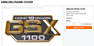

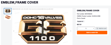

Hello folks! I recently had researched all the possible websites (yes, also eBay) looking for GS(x)1100 lateral panels badge with no success. I have a 3D version printed but I found impossible to replicate to color scheme on the metal badge. Do someone have/had made a vinyl printing for this? Cheers!

  • GSX 1100 Emblem:Badge 01.png
  • GSX 1100 Emblem:Badge 02.png
Thank you very much for your answer. But my text is not very complete, my 3D print is a plastic printing. New badges are rare nowadays. That's why I thought about vinyl and clear coat over it.
You can plate over plastic by using an intermediate layer of metallic paint. It's super common practice in manufacturing these days.

Crazyramen, I'm not familiarized with plating yet, the website you sent me is great, but I was overwhelmed about so many options, can you tell me which is the metal plating on plastic you are referring to?

Bottom paragraph at that link:
"Plastic parts can also be plated with our Acid Copper Plug N Plate system after painting with conductive paint and swabbed with Tinning Solution."
You'll also need something to go over the copper. The compatibility table is here: https://support.caswellplating.com/portal/en/kb/articles/plug-n-plate-kit-instructions
I haven't plated on plastic yet, so I can't speak to how important their tinning solution is, but I have plated on metal using similar brush plating techniques with good results.
Some day I'm going to try plating on metallic 3d printer filaments. We'll see how that goes, since they're only ~15% by volume.

It's an outstanding world on this subject! Lots to study! Thanks for your interest on my post!
