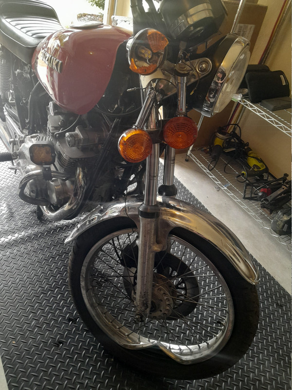

It's raining today, so instead of riding, I installed a different headlight bucket (emgo 66-64313D) so i can run automotive lamps instead of sealed beams - which they don't apparently even make my size of them anymore (some kind of honda special 6 1/4 bulb). It came with a halogen, and it does look a bit brighter than the incandescent that the bike had stock. I do want to try out some led bulbs since I have an sh775.
it didn't come with hardware, so i ordered some stainless, and i'm glad I got a 50 pack of washers because i needed them. I knew I would have to shim between the ears. But I took a wild guess on the length of bolt needed and ended up guessing about 10mm too long.
anyway, it still looks relatively stock. though it's a bit smaller. only a real GS nerd would notice.

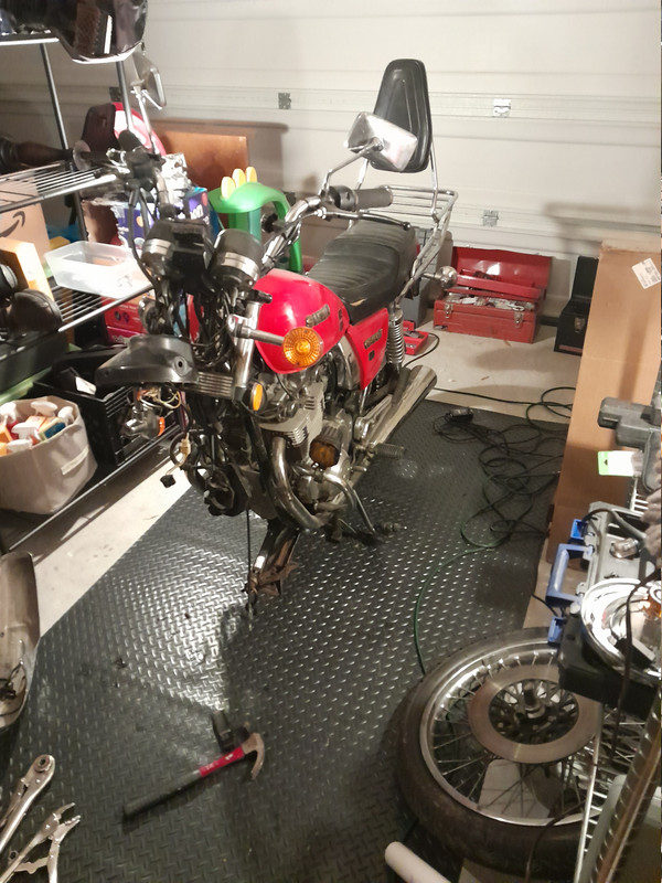

I got in a wreck on the bike in september '25. it wasn't too bad of one, i got up and walked away. lady turned left in front of me and i couldn't quite stop, i kinda glanced off the side of her minivan and flopped over on the high side. my gear is all fine, except for my right glove which is shredded. i did hit my head on the pavement, but it didn't hurt thanks to the helmet; i got a nice elbow scrape, even through my mesh riding jacket; and the bruise on my leg was quite impressive.

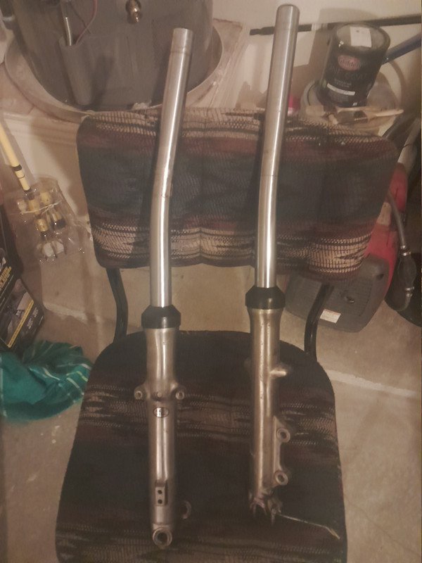

the bike is repairable, it's all front end damage. parts are flowing in now. i've got a new wheel and bearings, new forks and axle, also a new stator from rmstator, to pick back up on fixing the electrical issues. the new forks were from a later model 450, looks like they have those air nozzles on them. also gonna replace the shift shaft seal - say that one three times fast.
i'll post a pic of the damage later. bike is now salvage :) but she'll ride again soon.

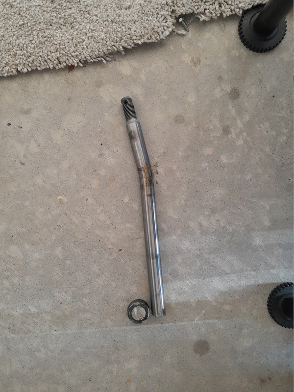

the fork tubes got bent, and the (spoked) rim got mushed where i hit the van's running board. the poor front fender is ruined, but i will worry about aesthetic stuff later and just bend it back until it's good enough.
i'm grateful to the PO who added engine guards.
welp .. had to use the angle grinder on the axle but got it all apart.
i'm bringing the new wheel to a shop to get trued up and what not.
i'm gonna attempt to rebuild the forks myself. the old ones were on the way out anyway. i had to sand one of them down to stop a seal leak, and had to sand thru the chrome. so a matter of time before that started to corrode.

on to the forks ...
