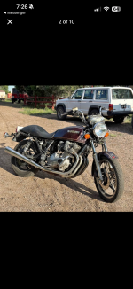

I’ll start at the beginning a couple weeks ago I bought a very neglected 1980 gs850 I got it running and have now done a lot to make it look better. I did an oil change with new filter. Replaced all the plugs, replaced the pads and bled and drained the old fluid. In the process of putting the carbs back on I’m having a guy clean them. Before I go any further I should mention I also got a 1980 gs1000 for free. So I am going to be using the 1,000 carbs with the 1000 boots and airbox because the 850 carbs were pretty bad and the 850 airbox was junk. Anyways here a couple pics of the bike now. It is leaking oil from somewhere so I need to figure that out and also need to figure out why it smoking out of the right tail pipe. Also is anyone in here in the Denver area?? Could really use another set of eyes and hands on this thing. I’m pretty mechanically inclined but not for stuff this old. The last picture is what it looked like when I bought it.

Welcome, good luck with the bike as well as finding help... Are you sure picture 3 is the same bike as picture 1 and 2??? I would have never thunk it, it sure looks different. You've done a lot of stuff so far... Keep it up and keep us update.

It sure is! All in 2 weeks haha I’ve really been grinding on it. This weekend I’m thinking I’m gonna cut the rear off about 6 inches to match up to the rear seat my whole plan is to cafe racer it!
