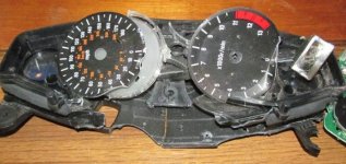

Testing the cluster on my home made simulator.
I was able to replicate it with the simulator. It's really an odd problem. The simulator drives a fixed signal into the ECM. The logger shows the quantization noise but that's it. The cluster on the other hand just wanders. The other bad cluster had the stepper driver fail. Maybe this is a similar problem. I found a few damaged clusters that I hope to scavenge to repair the two problem clusters. One looks like it was in a fire crash, the other had hardly anything left. As long as the ICs are still alright, I should be able to use the. In the mean time, the last working one was donated to the bike for now.

Ferrite would normally be used for higher frequencies. The simulator doesn't really have ignition wires. It uses a custom wound pot core to simulate the coils. The ECM reads the analog signals and then sends that data to the cluster over a digital serial bus. The cluster then decodes that information and drives the various gauges. These are mostly stepper motors. So basically its all digital.
Because it is digital, I can sniff the serial bus with a PC and some software, basically making my own cluster. When I look at the data the ECM sends out, it's fine. Everything on the bad cluster is stable except for the coolant temp.
When the gauge is first powered up, each gauge's needle will go to their maximum position, then to their minimum as a sort of self test. There are no problems during this self test. This particular GS (gen 1, K6) uses the temperature gauge to warn the driver of a problem. Don't ask me why they did it this way. If the check error is displayed, the coolant temperature gauge will read max but the over temp LED will remain off. I guess it was done because the driver may not notice the CHEK on the LCD but the over temp may get your attention. This all seems to work correctly.
In this case, there are no faults and the coolant temperature acts like an analog gauge, moving around.
The tachometer on the other bad cluster is the problem. I can heat the stepper controller and it will start to work but it's not a soldering problem. It appears the IC itself has gone bad. Once I get the junker cluster, I will try and sort it out.
Guessing someone died on the bike this one came from. That's some major damage. The circuit board was damaged with several components tore from it. The main controller IC is cracked right down the middle. Still, a lot of good parts and that stepper controller is what I needed to repair the first cluster. Lucky, that side of the cluster was not damaged. The one needing repairs was made prior to them conformal coating the boards. Made it easy to swap out the controller. Appears to be 100% functional now. Plan to let it run for a few hours and then will have a look at the other cluster. cluster1.jpg
