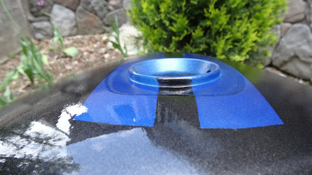

              got the tins painted on saturday, still waiting on 2k spraymax to get here to clear them.
              this what i started with
              and outcome

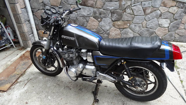

                #52
                here is a final result after couple coats of 2k clear. i dont mind orange peel and think it came out much better than i thought it would. still need to wax it.
