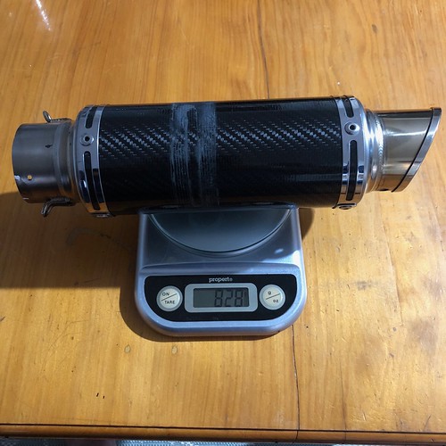

While the Kat has been waiting for the refurbished starter clutch I went shopping and found a short length titanium and carbon muffler for the project. The muffler arrived today and was very pleased to see it weigh 290 grams less than the carbon muffler in current use.
Curb Weight Running Tally: 197.475 kg.
The old and new mufflers length compared.

Hhhhmmmm, those mirrors need to be re-visited, they are a bit chunky so I have ordered a new set and although the supplier couldn't provide the weight to me, the new mirrors look to be a lighter construction. Will know for sure in about two weeks.

The mirrors arrived today, four days early, gotta be happy with that! Even better news is the weight, 459 grams lighter!!!!!! I rolled the dice on these in the hope they were lighter than the current mirrors and they certainly are much lighter.
I like the slim profile and the angles as well as the light weight design, including the glare reducing blue lens. Next step is to test them tomorrow on a ride. I'll amend the running tally if they pass the test ride.

The light weight mirrors did not workout to plan, limited vision and the other issue is they work soo much better when attached to the scooter. For now the old mirrors will be re-installed along with some other replacement parts. No change to the running tally this time.
