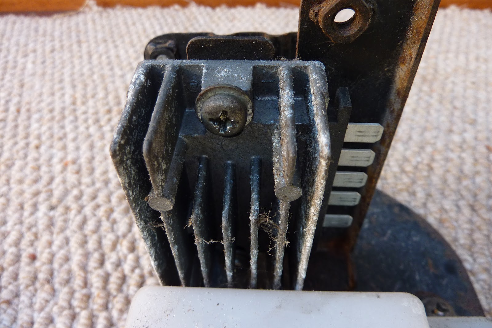

    I think we did have the original rectifier. See what you think of this:
    Rectifier Photos on GS1100 Blog
    Richard

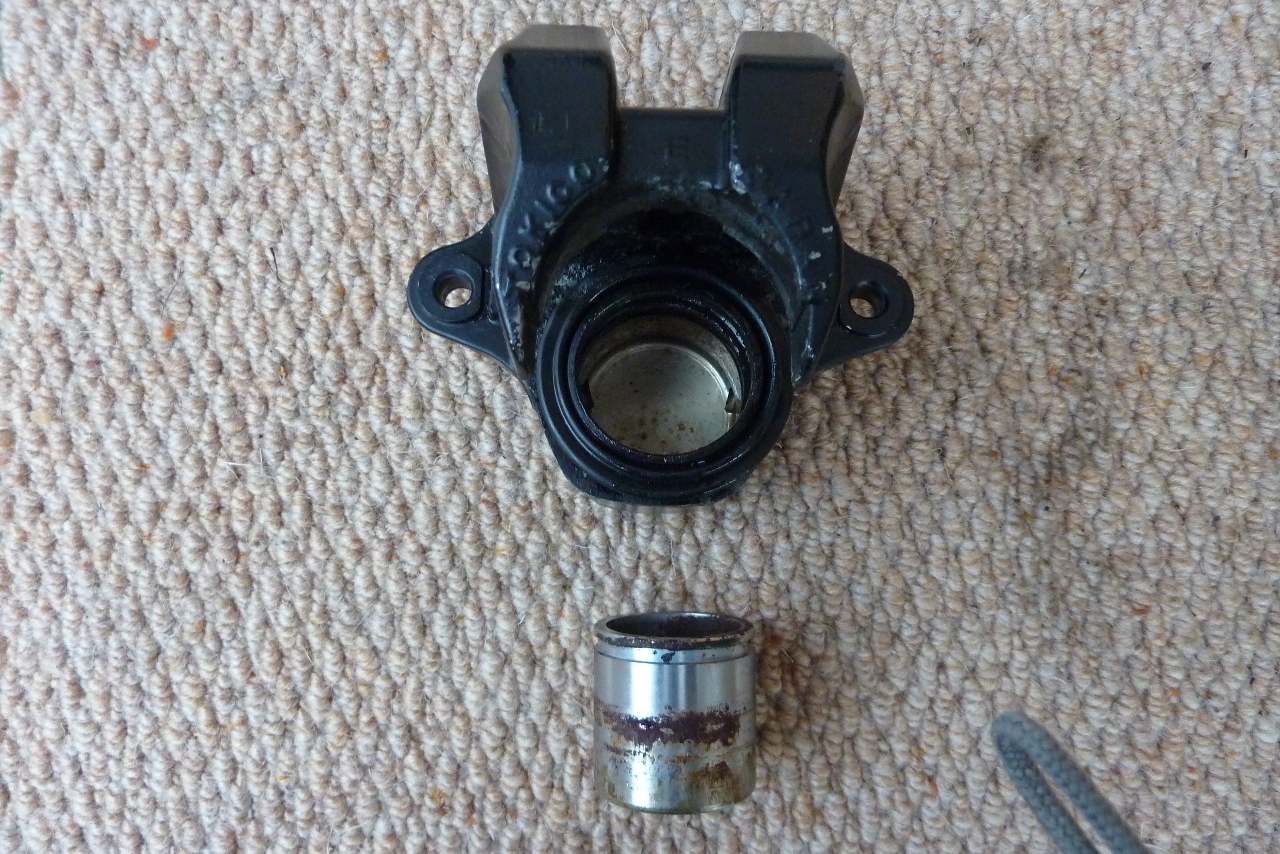

                    Day 68 Front Caliper Seized
                    More stuff coming off the bike. I knew the all the brakes were seized before I took them apart. But how do get the seized pistons out? More concoction (50% brake fluid and 50% thinners) is needed me thinks.
                    See the blog here: Front Brake Caliper

                      #70

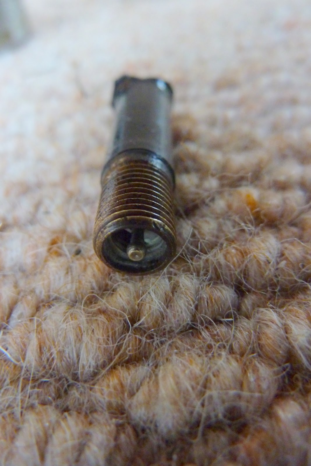

                      To get the pistons out hook up an airline to the hole where the banjo fits. Make it a push fit using a plastic round piece that you get in the kit for pumping up an airbed etc. Place a thick rag quadrupled over on top of the piston - it'll fly off (and keep fingers out of the way). If the pistons are marked on their sides - even slightly - throw them away. Replace using stainless steel ones and the job is done forever - I think Nick Chambers has them.
                      Be really careful with the bleed nipples - plenty of your concoction on them before attempting to unwind them (they snap like carrots). Again, replace with SS; buy direct from HEL - they're half the price of anyone else.

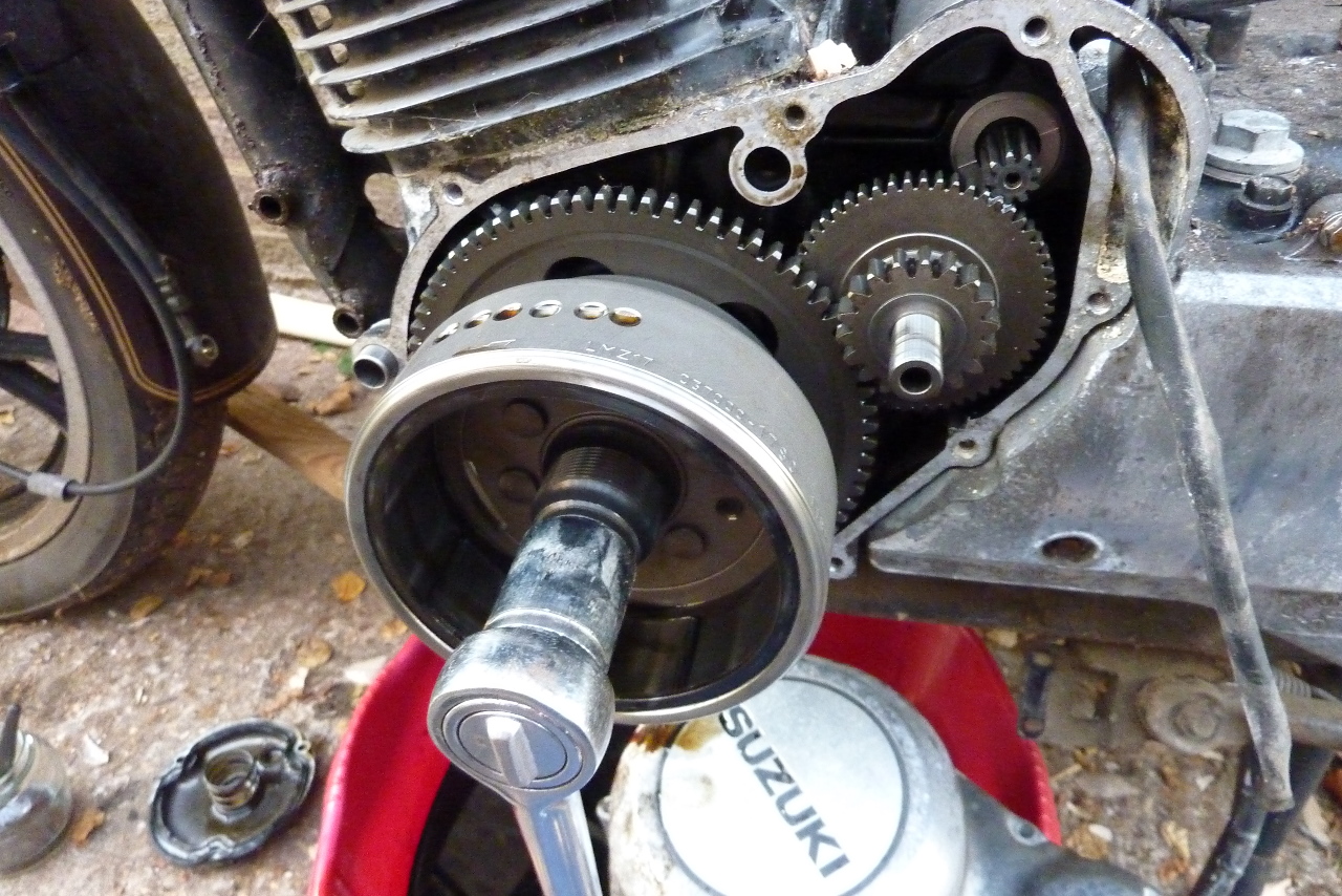

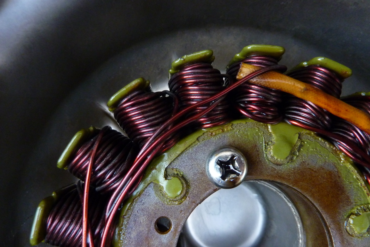

                          Day 69 The Stator is Revealed
                          I've heard and read so much about these darn stators so I just had to have a look. Was an easy job getting the side off and I wanted to ensure the engine was fully drained of oil as I will be working on it inside a bit later on.
                          See the blog posting: Stator is revealed.
                          And the best bit is that the engine cranks really nicely. No seizing here. I was never sure about this as the front rear brakes had seized and the last time we moved the bike we could not determine is the engine would turn as the wheels would not turn. So that is very good news.

                            Day 77 Front Brake Piston Removal
                            (sorry - I have been away for a week. I took my boys to Holland for half term)
                            Well thanks to Hampshirehog the job is done.
                            See the Blog here: Front Brake Piston Removal.
                            It's really simple; you just gotta do what they tell you. Attach a foot pump to the air valve which is jammed into the banjo hole. Pump and pop.

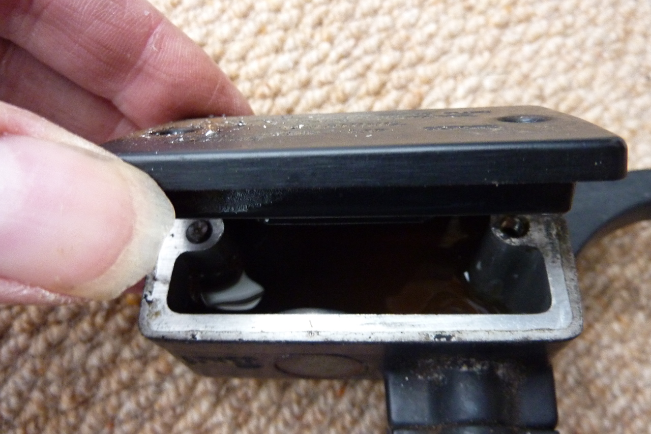

                                Day 84 Front Brake Reservoir Screw Problem Solved
                                Solved my problem with a little drilling.
                                Here is the blog: GS1100 Blog
