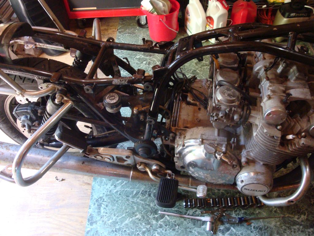

 Next on the agenda is tearing down the bike to strip it down to the bare frame. This is done to check out the parts and to see whether things are missing, swapped out with the wrong parts, as well as to check for damage. I also plan on painting the frame so everything needs to be off of it.

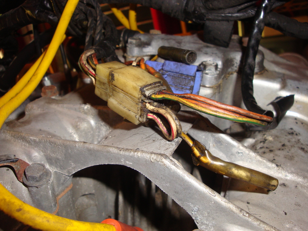

 I will also pay attention to all the electrical wiring and the connections to check for hot spots/melting due to the GS's famed "Stator" problems. Don had mentioned that the bike had stator problems in the past, so odds that melting has occurred are pretty good. He also mentioned that when the bike is parked, the battery drains to nothing so this is something that I will keep in mind as I tear into the wiring.
 So my plan is is to take things off the bike from front to rear and get the bike naked. I have an official Suzuki GS1100GK manual on the way so that will help with the rear end since I haven't dealt with Suzuki shaft drives before.
 As of 6/21/15 I have most everything off the bike except for the front fork & wheel, the engine, and the rear wheel and swingarm. I'll be taking them off soon,

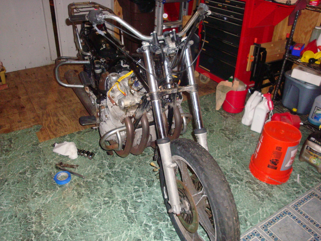

The front end disassembly starts
Electrical heat damage

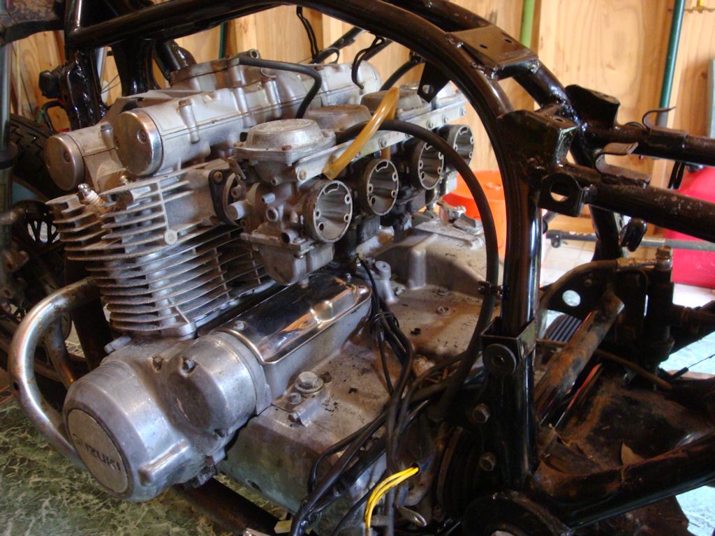

Got the airbox and all electrical ripped out
Another view of all electrical ripped out

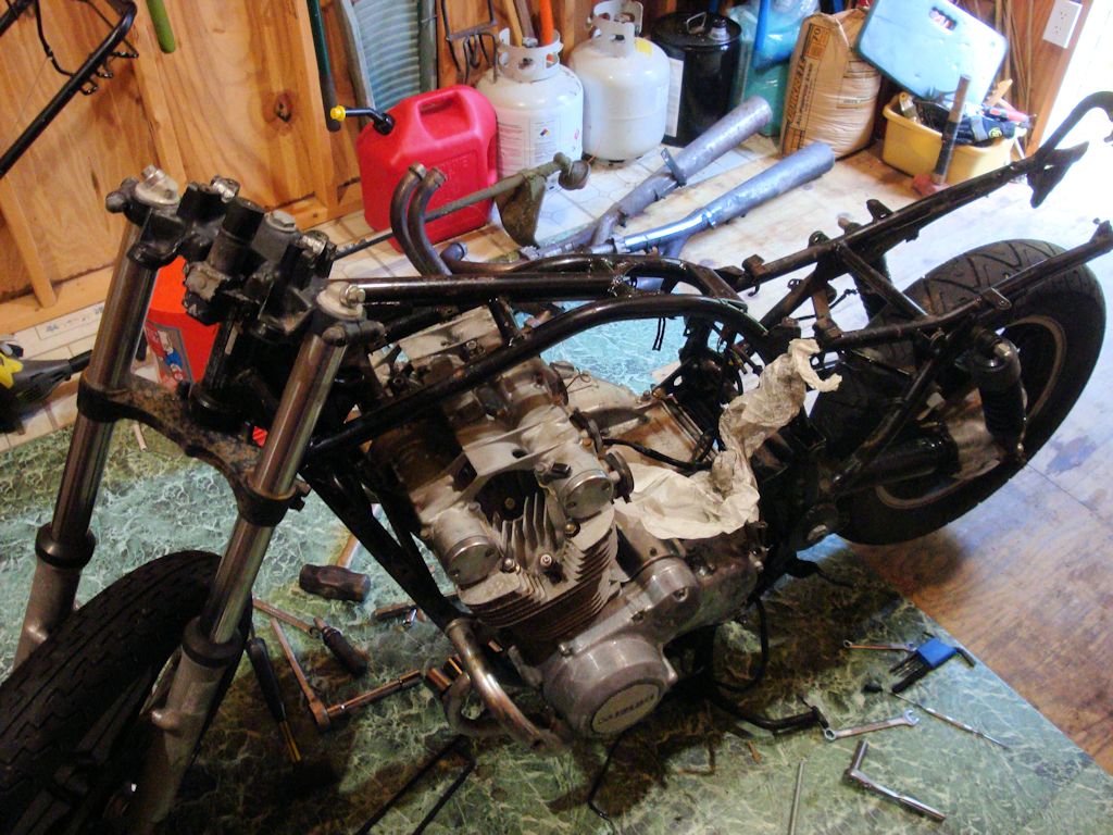

Most of the parts are now removed

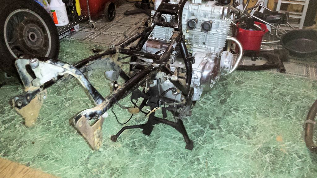

Update on 3/12/16 - The rear wheel, shocks and swingarm are removed.
